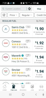

My typical fill-up is usually around $75-80 based on how many Kroger points we have. It's always limited by their 35 gal limit, however. I usually fill my main tank and then put any extra into the aux 43gal tank to hit the limit.
Feel your pain with all the Washington taxes. Thankfully I am only 10 miles from Idaho and gas is easily 60 cents to $1 cheaper
Costco Spokane $3.189
Costco CdA $2.269
