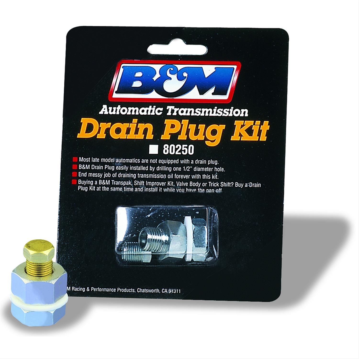

When I originally pulled off the pan a while back I had one of these in stock, thinking that I'd just drill a hole and thread it in place in the stock plastic pan. Well, that didn't work. The pan is all honeycomb structured, leaving no suitable place to stick the bung. So here I am...still mostly interested in this stuff for the drain plug.
