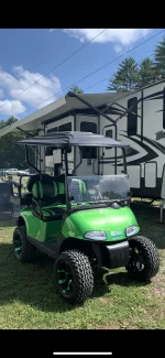

Don’t forget to put 5grand aside for a golf cart. And for you, maybe 10. As you might want a custom cart that looks like your tremor

Damn man, my cart sux
