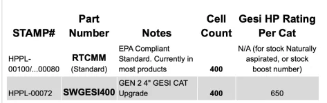

*** NOTE ordered redline exhaust and 2.0 inch headers from stainless works --- the regular catalytic converters were shipped with them --- confirm when you order with them that you want WGESI400 cats and not the RTCMM ones **** there is no option online website for this to pick/choose which cats you get.
