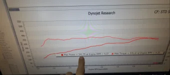

Baseline Engine Rating – 430 hp and 475 tq
Baseline Dyno – 341 whp and 370 tq
Roughly 20% and 22% driveline loss
After Install Dyno – 612 whp and 598 tq
If we consider 20%/22% from baseline – 765 hp and 766 tq estimated at Engine
It is very noticeably faster than my Supercharged Tundra and it’s 90% of what my TRX was (at least passing power wise). I do miss the awd from the TRX but I love everything else about this Ford. Next round of upgrades will be traction bars – I do not have any wheel hop as of now, 58-gallon fuel tank, and a big break kit – I currently do not have a front sway bar but I might add now. Extremely happy with how it turned out.

Thank you for posting dyno numbers! I tried to get mine dynoed but it was a fail. They did it in the wrong gear, they didn't take it to redline, and somehow I only hit like 5 lbs of boost. It was a total waste of time and money.
