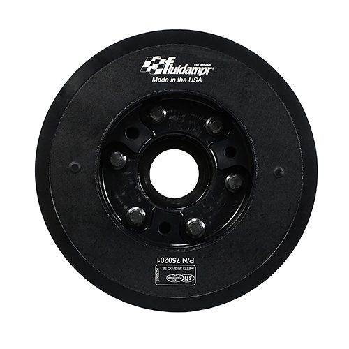

I just installed a Fluidampr, 750201, on my 2024. BTW, many vendors show this damper only works for 2020-2022, but it does work for all current SD 2020 and up. The whole reason for this project was to pin the crank. I was going to replace the crank seal while I was there, but they are on national backorder and won't see them until June, maybe. The dealers who had a few won't sell them. Pretty straightforward, as I removed the fan and fan shroud. I had the front up on ramps and removed the steering damper below to gain access from below. To install the A/C stretch belt, the Ford shop manual shows that you use a zip tie to hold the belt on the rear pulley and rotate the crank to slip it on. Fluidampr does not have any holes for a zip tie, so I removed one of the 6 bolts that hold it together, which allows you to use a zip tie. Reinstall the bolt with red loctite, and Fluidampr said 40 lbs/ft.
Trying to hold the damper while torqueing the ARP bolt, 125 lbs/ft + 90 degrees, with a strap wrench is a challenge, even with two people. I just found that Fluidampr sells a holding tool, part number 300020, so I'll recheck mine when it shows up. BTW, ARP confirmed that their crank bolt is reusable, unlike the OEM bolt. The ARP bolt takes a 12-point 21mm socket.

I bought the Innovations West puller/installer kit along with their Godzilla adapter, which is a must to install the damper, as the threads in the crank are back in there deep. Since the OEM Ford damper doesn't have screw holes used for removing it, you need a puller that has 3 claws.

I'm also ordering a Fluidampr 750201 crank damper. Much better than the OEM rubber-isolated HB. I've already seen a broken crank snout on the forums. I got to call them this morning to verify a few things. This is an easy install as our cranks are internally balanced. Summit and Jegs have the best price I've found. My pin kit comes today.
For the Godzilla, we need a special bolt to install the HB, as the threads are deep in the crank, and we need an extra-long bolt/tool to install it. This place has it, along with a great puller/installer kit.
Also, putting a new compressor belt on since they are cheap and have to be removed anyway. PN: PC3Z-8620C. Also, a new front crank seal PN: GK2Z-6700D.
I'm posting all this in case someone else may want to do this. I figure I'll have it almost torn down all the way, might as well upgrade the damper.

It has a damper on it from the factory already. It's an internally balanced motor, so it has a damper instead of a harmonic balancer, which is used for externally balanced motors. The reason I upgraded the damper was that I needed to pin the crank to the damper because I was getting elevated iron on my oil analysis due to the press fit and the damper slightly slipping. The drag caused by the Whipple can cause this. So I put a better damper on while I had it apart.

There are several kits out there, and I picked one that has just 1 pin. I wouldn't think 2 would be necessary at our power level. I got the Pro Charger kit for Godzilla.
