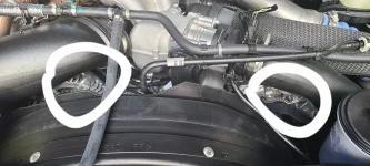

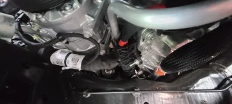

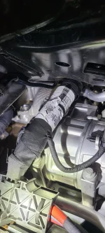

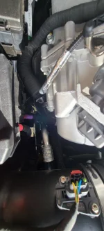

Ok so I don't believe it is possible to add a second alternator or battery to the wiring harness unless you replace the entire harness .... Which if you ask me not worth it on a 70k or 80k or whatever k truck... The second battery harness is connected to the second alternator but also the first battery as well and fuse box
In the picture I traced the second battery cables from the drive side to unless the truck and the harness also connects to the alternator and then to under the truck where is goes into that black plastic conduit and runs from drive side to passenger on the front of the oil pan and then goes back up to the passenger side battery and fuse box and run along to the back of the engine to the starter... I don't see a say to just add the harness .... YES YOU CAN add wiring to your truck to add the battery and alternator using your custom wiring job but I wouldn't but Yes you can do it but no you can't easily do it .... But I would just add the winch with a single battery and alternator I don't see it being a problem I don't on my Jeeps all the time just run at a higher idle and it fine but you won't be able to get the factory winch you will have to get a aftermarket winch and find a way to wiring it up but IF YOU HAVE THE UPFITTER SWITCHES YOU ALREADY HAVE Dual battery and dual alternators

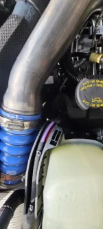

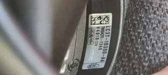

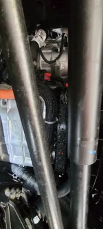

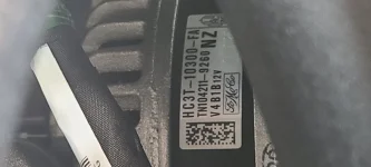

Here is a picture of my alternators but looks like same serial number for my 6.7 .. worth a look

I do and the part numbers are all the same.
Well at we know the alternators are not different between the 6.7 and 7.3 but they are mounted different between them ... You have alternator tower and I have alternator turbos hahahahaha...

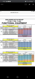

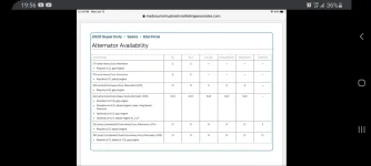

Here is some useful info
So you at least have a 157... But i would go for a 240 upgrade if you want to run a winch ... Which is possible with a single alternator and also classified as a heavy duty alternator as well.
