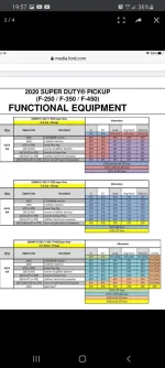

Here is a table for your options on alternators
I have a 2020 F250 6.7 with upfitter switches and an inverter = 240A alternator (dual batteries).
So I guess If I wanted to upgrade to 397 for a winch, they would stick a 157 in the 2nd slot, hoping the wiring doesn't need to change too much.
Question: Let's say I wanted my 2nd alternator to help power something else. Could I get another 240 in the place of the 157 for a total of 480? Or could both be upgraded to something even bigger? Or is there pretty much a reason 397's about as much as you'd want.
