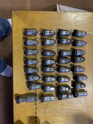

As a part of the oil change today, I pulled each tire off to inspect the brakes and give each tire a good inspection. While largely unnecessary at this point in the truck's life, and especially the life of the tires since they're brand new, I want to build up habits. I took the opportunity to install black lug nuts!
@BroncoHooves definitely was who pushed me over the edge for this on his build thread.
I love the look, especially if I'm going to run with no hub caps anyways. And I don't want the hub caps just for my own convenience. Means I don't have to deal with them whenever I'm taking wheels on/off, and don't have to deal with a shop cracking or scratching them.
Interestingly, as can be seen in the picture of the front wheel, the front wheel studs are painted blue. This doesn't look like thread locker at all, but literally blue paint. I have no idea why this was done. Anyone else's studs painted?

Don't forget a set of the Ford locking, black lugs. I think I showed them in my thread too.
Part: HC3Z1A043B​
And yes, the hubcaps removed looks better than stock!
Part: HC3Z1A043B​
You did! I've been waffling on them. I like the security, but I've literally never had locking lug nuts before and haven't had a problem. They also seem like a pain. One more key to keep track of and you need to make sure to give it to the shop before they work on your vehicle.

I gotta ask. Why run black open style lug nuts if the steel stud (not black) is still visible? Why not get a closed style black nuts for a cleaner all black look and also more protection to studs. (Not sure if these studs rust or not if exposed)
Yeah, mine are too. Which I think were visible in the build thread. Should go away with time.
Funky. Good to know it’s not just me.
It’s part of the look being able to see the stud and have it stand out a bit. Makes it more utilitarian.
Also: finding black lug nuts is nigh impossible for the OEM wheels unless you go with an Amazon special, which I wasn’t going to do. So I’m kind of stuck with what I can get. These lug nuts are take-offs from chassis cab trucks, which means they are Ford OEM so I can fully trust them.
As for rust, time will tell but I’m quite sure these are galvanized to protect from corrosion.
I’m thinking about painting the very tip of the stud if my ocd continues to escalate. The part unaffected by torque values. Since i’ll need to touch up the rear hubs with paint eventually too. No big deal.
Is there a way to paint them such that you won’t need to touch them up every time you take the lug nut off? Or is that something you are ok with?
Every tire rotation is fine. Twice a year or less for me.
