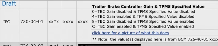

The only change I attempted that didn't seem to work was the Tire Pressure Placard on the TPMS page
@yArdbird are you trying to change what the recommended setting shows or something else? I changed mine in the As-Built and it is reflected in the vehicle settings and FordPass:
@Modman I successfully changed the recommended psi front and rear successfully through the BdyCM plain English module and the change is reflected in Fordpass.
I was trying to add the tpms placard like the picture below. It was the only change I made that didn't seem to take effect. I haven't driven my truck today and it was one of the last things I did so it might take a couple of key cycles.
Note: the below photo is not my picture, but I followed a link in Livinitup's 2015-2020 F150s spreadsheet.
Got it! I honestly don't remember even seeing that... I'm going to take a look right now.
Mine doesn't show that:
Just reread your post... So you are trying to add it... Understand now! I'm a little slow tonight anticipating the turkey! 🦃
This is from the spreadsheet I referenced.
I don’t have my notes in front of me, but I believe mine was originally 0 and I changed it to 8. Looking at it again this evening, I realize I might have to change something in the BCM also. The link for a picture is the picture I posted previously.
Nor do I... I have referenced the 21MY F150 spreadsheet for other things since that is also a Sync4 system and it seems to match our 22MY trucks. I'll take a look at it tomorrow.
@yArdbird I checked the 21MY F150 spreadsheet and it is a little different, but "8" is still the correct setting to enable the placard display:
This seems consistent with my As-Built data: 720-04-01 E002 0080 018F
Also, for our Trucks the TPMS setting is held in BCM 726-10-01 (fr) and 726-10-02 (rr), not 726-40-01
