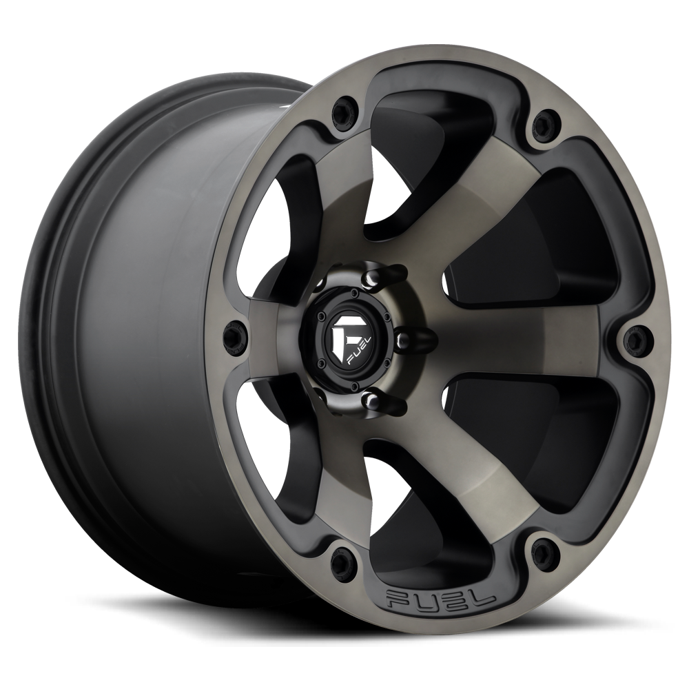

Just did wheels and tires last week as the stock duratracs gave up the ghost at 28.4k miles. Seems like the consensus here and to be safe, I went with the following as I did not want to rub at all. I am stock suspension/height aside from Bilstein 5160s. I would've loved to do 20x10 as that is what my excursion had.
20x9 (+1) Fuel Beast
35x12.50 (F) Toyo MTs.
Here are a few pictures as lighting seems to change the fuels, this is the best offset photo I can get.
