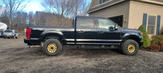

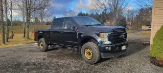

Hello, I recently picked up my 22 F250 Tremor. First order of business was to upgrade the wheels and tires.
Wheels: Vision Manx 2 Satin Grey 17x9 ET+12
Tires: Nitto Recon Grappler 37x11.5 R17. Nitto tech support recommended I run them at 54FR/59RR PSI. I have them at 50/50 currently.
Zero rub, no trimming, 100% stock truck
Tires line up perfectly with the fenders as planned
No downsides, no regrets
With the tall sidewalls, I am really enjoying the slightly improved ride and not having to worry about scuffing or bending the wheels when running over curbs, potholes, or when off road.
The truck still wanders a bit like it did with the Duratracs. I havent had it on an alignment rack yet, but it feels to me that a bit of caster correction will fix it right up.
Tire noise is notably quieter at highway speeds, but equivalent below 50 MPH.
While not for everyone, I dig the look.

Looks badass! I didn't even know there was a 37x11.50r17. Only seen the 37x11.5 on 18's and 20's.

That looks tough! It's nice you can run that size without a lift and trimming. (y)

Thanks for posting these! I’ve been waiting a long time to see good photos of a 37/11.5 on a tremor.

I have the same truck, paint scheme and all but a F350. I love the look! great setup.

I had thought I had seen they had be discontinued. I like the way it does not stick out like the 12:50's
