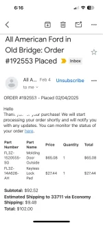

Where did you order these parts from, my dealer is marking them up significantly.
Try these two links.
I ordered from ford.oemparts.com but my invoice in my email says they came from “All American Ford in Old Bridge” which appears to be a dealer in New Jersey. Not sure why they shipped from here, maybe just selected a dealer based on alphabetical order and they were on top? I likely landed on this page just from googling the part numbers.
