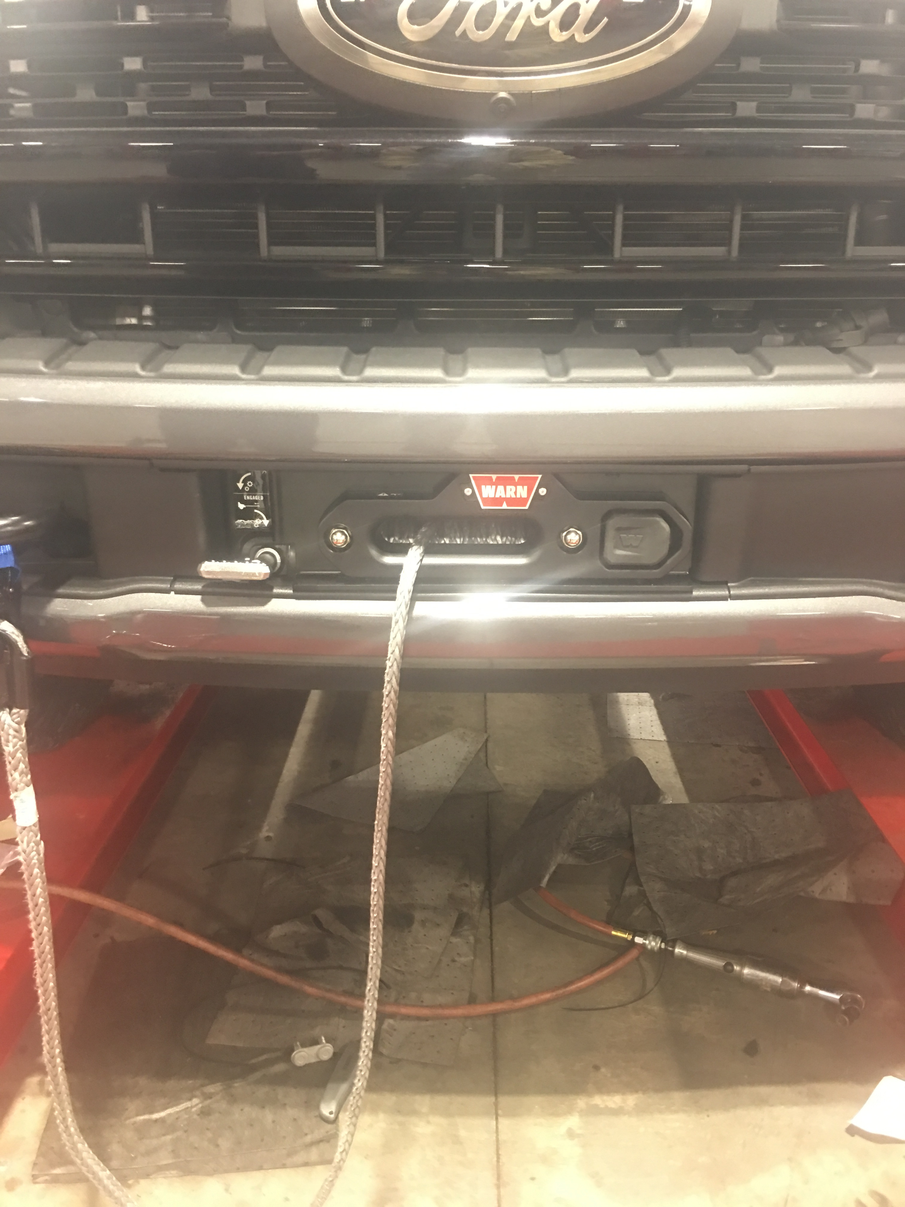

@Fordseniormaster
Thanks for taking the time to post this info, but most of all, thanks for being such an ass kicker. I really enjoy it when people take initiative and refuse to travel the "that's close enough" path. You've done this site and this growing community an incredible service. ?
My dealer was able to perfect follow your lead and my winch instal looks incredible....
MB
@Fordseniormaster
MB
Looks good, i absolutely hate when i see shady work. Its way quicker to do it right the first time. I try and will continue to try and help as much as i can. I get crazy busy trying to keep these Ford's rolling. By the way not sure if y'all have seen the new TSB for the trans issues that we have been having. LOL.
But thanks for the kind words, in my business the only customers we seem to hear from is the ones that are pissed off, nice to hear good stuff also.
