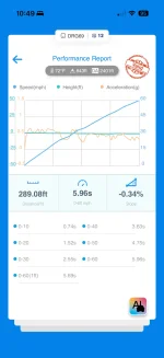

The above is my best four-wheel-drive boost launch from first gear, stability fully control off. Not posted here, I was able to shave .2 off the 60 and quarter mile times when I shifted manually. But it was so inconsistent and hard to pull off. It wasn’t a realistic number.
In hindsight, I do wonder if a second gear start would’ve worked with the Whipple truck.
And yes, a keen I will spot da is different. In the end that makes no difference for two reasons, one being the injector limit limited power at that temperature anyhow and secondly, the diesel isn’t much quicker in the cold weather and the 60 gallon fuel tank weighs a lot more.
I think this data supports my driving experience. It shows the 7.3 pulling harder in the upper speeds and with an overall higher max speed. I always thought the open road accelleration to pass or just for fun was incredible. So, how does one improve shifting and lower speed accelleration? Paddle shifters and??? Maybe its time to think seriously about the Raptor steering wheel swap.
