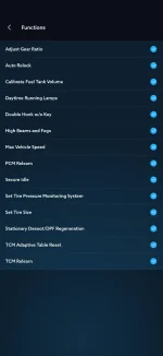

there are setting you can flip that mimic forscan (TPMS, Bambi Mode - Fogs with Highs, double honk and so forth).
