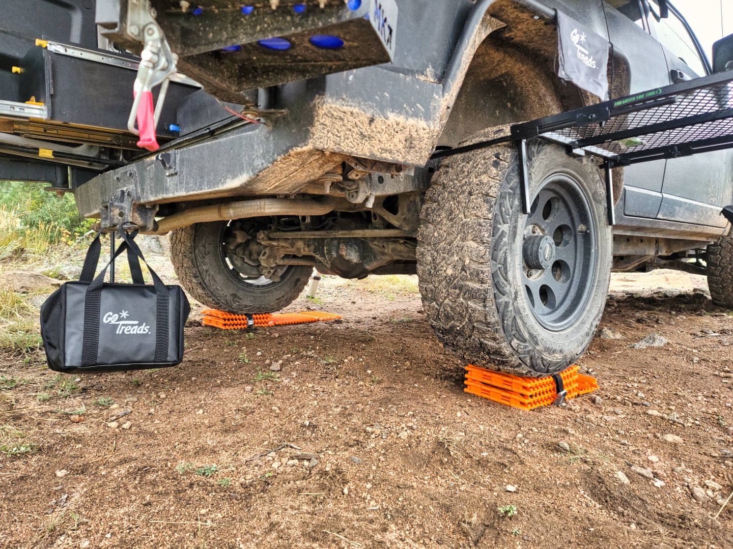

I have a set of these in the truck, good for minor stuck situations and leveling.
I do as well. I like items that serve multiple purposes for occasional use. The GoTreads fit this criteria well and don't take up much room...
