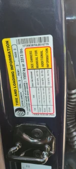

you must have the 10k GVWR becuase i have the 11500 GVWR and my F350 6.7 payload is 3313

Yeah @Pizza Man and @vegasdrummer - I think you have the GVWR derates on your trucks.
Looking at Pizza Man’s window sticker he has a F250 with a 7.3L so 10K is max for the selected options. Comparing to my F350 which is a very similar build the payload numbers seem to line up with the expected 1300lb difference between the F250 (10,000 GVWR) and F350 (11,300 GVWR) with the 7.3L. Mine is at 3826 by the way.
Vegasdrummer probably has a 10K derate F350.
Gotcha - was thinking they both had F350's.
