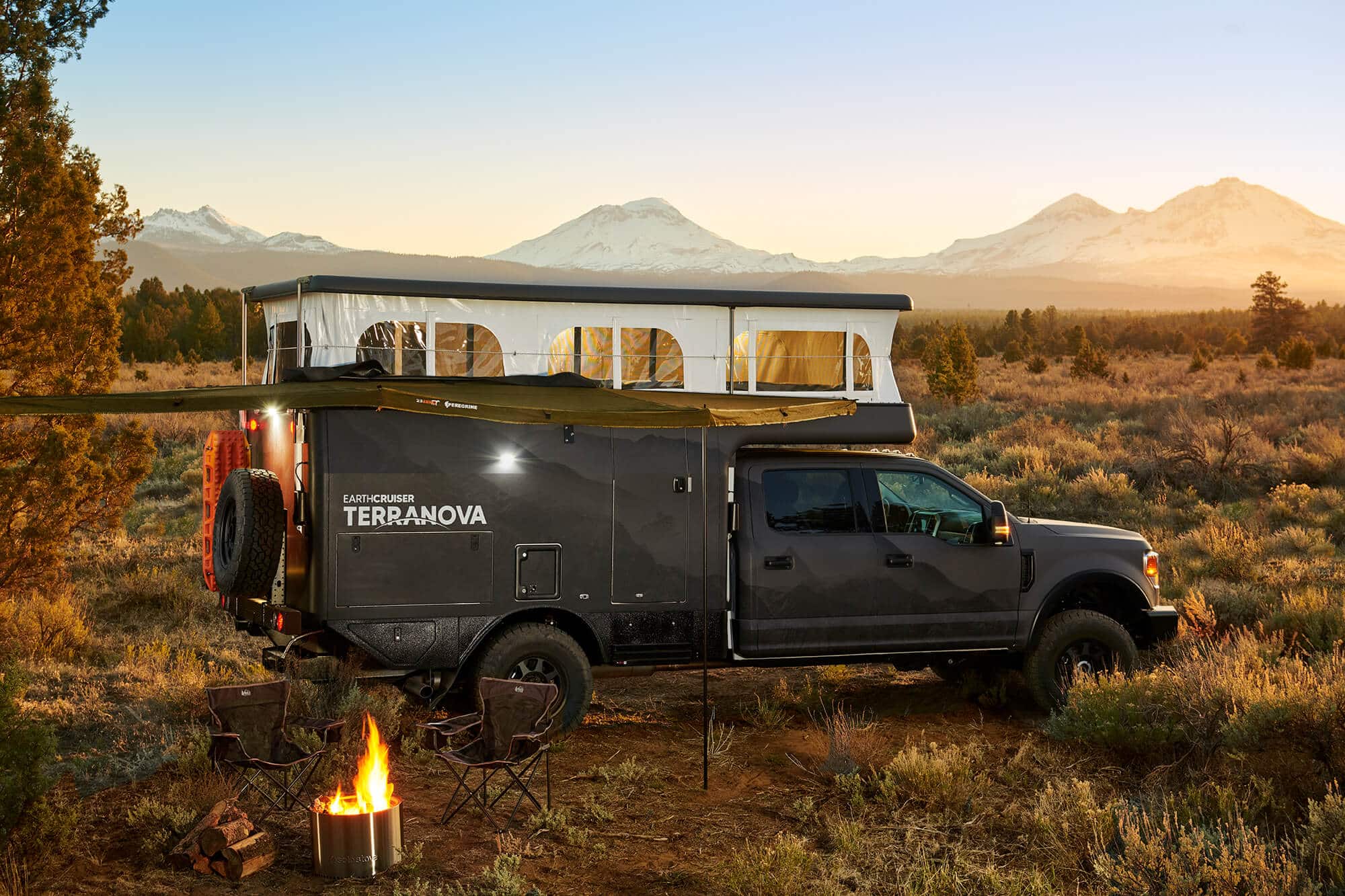

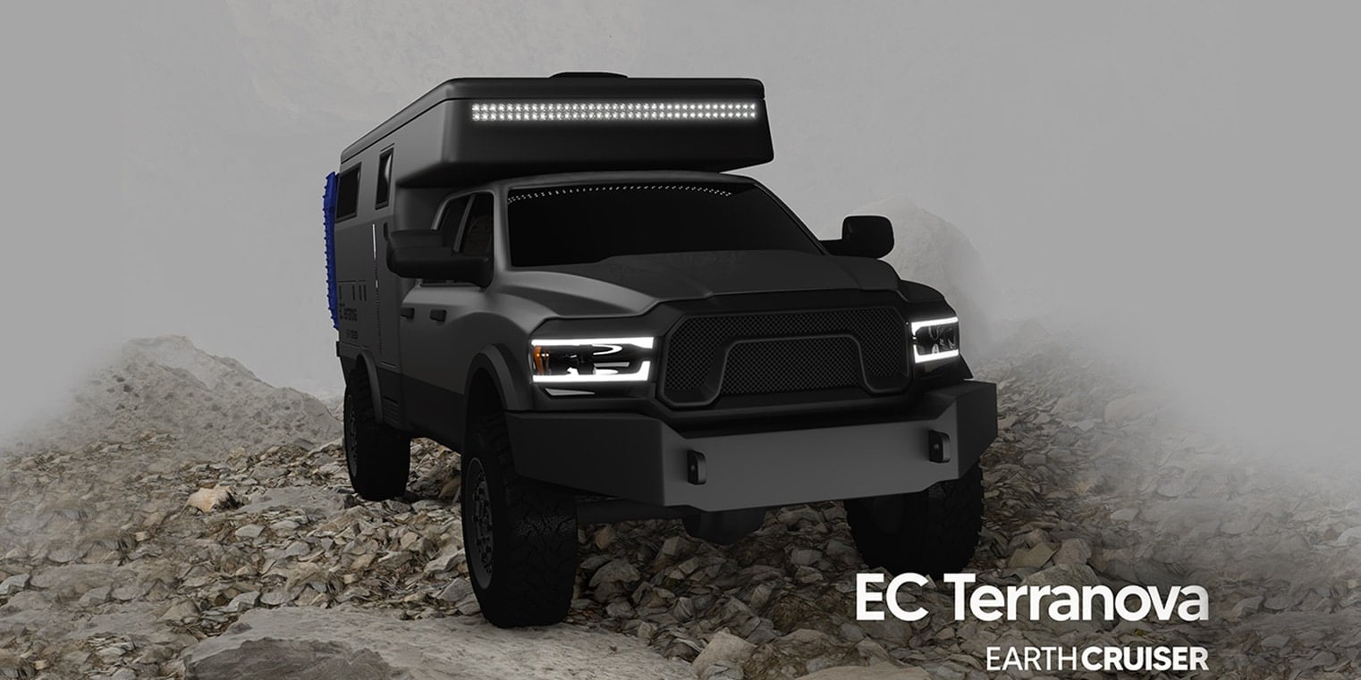

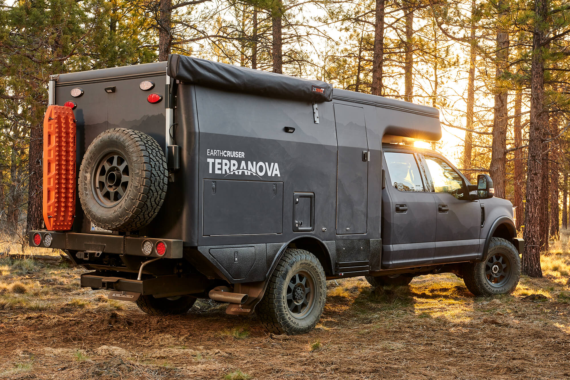

Here's another option if it looks interesting to you. I think this is way cool.
For context, expect that to start comfortably into 6 figures. EarthCruiser stuff is high quality and incredibly well designed, but you absolutely will pay for it.
Looks awesome! Very inconspicuous and on a flat-bed. I'll have to check it out.
