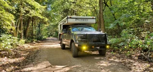

Camper weighs 2800 lbs dry, dirt bike about 230 extended 42” from receiver. Rear sag is about 3 inches. Front drops about an inch. Interestingly the truck sits almost level. The added weight of the 6.7 may contribute to this. Only issue is headlight height and sway. This photo is with all stock. I may add Upper and lower stableloads, but not air bags.

Wow definitely don’t notice the sag. I am about 1850lbs full loaded.
