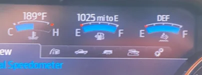

Here is an update on my experience with the TF tank. Its fantastic.

I haven’t mustered up the nerve to use FORSCAN to update the tank size yet. But I will so I can receive more accurate DTE readings.

Today I followed the excellent instructions at this link
https://forscan.org/forum/viewtopic.php?t=14698 and updated my fuel tank size. The distance to empty jumped from 175 miles to 368 miles after I did the update. I found that it is important to follow the second forscan update (for 2020+ F-Series) in the instructions and change the Fuel Level Source Parameter from PCM to IPC. After I updated the tank gallons I botched this second step and did not save it. The DTE reading did not change. When I went back and updated the fuel level source to IPC the DTE reading changed from 175 mi to 368 mi.
