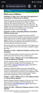

Anyone read about FORScan no longer issuing/renewing licenses due to sanctions against Russia? If you didn't renew on December 17th, you're SOL:
That's unfortunate. I believe the Windows Extended license is the only way to access the configuration and programming application. :(
Probably. My truck is at the shop getting a facelift and the guy was angry that he can't do anymore stuff. His renewal was January 1st. 🤦
