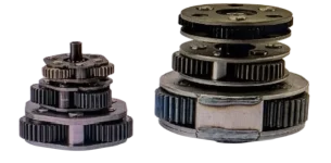

then you will really hate the small puny gears in the badlands winch. Pure chinese junk.
Have you opened up a badland winch? I have, I've even broken one. Completely my fault, and I was able to contact harbor freight point out the parts I broke off the build diagram included and they sold me the parts I needed (cost about $45 with shipping) and I was able to put the winch back in service. There is nothing puny inside the winch, it's a very well designed product. Now I don't have experience with taking a Warn apart but I'm sure it's as good at the very least as the Harbor Freight ones.
Yes, I love showing people how cheap and inferior they are.
Tell me which one of these comes out of a quality Hd 12k winch and which ones comes from the “nothing puny” badlands… I’ll wait…

Because what I love doesnt mean its plausible... For instance, i dont think a 16.5 Warn is fitting behind the bumper. But Ill share what is and what isnt. Especially with misinformation.
