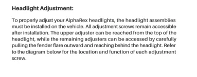

Not happy with how to adjust the lights. As you do with stock halogens, you have the one screw/adjustment piece on the top that can be adjusted with a Phillips head.
With these Alpharex there are 4 spots to adjust (refer to attached image). In theory, doesn't look difficult.
However, once installed, especially for driver's side, these are practically impossible to reach. Passenger side ain't much better. I removed the wheel well liner, but could not access any of these adjustment points. My driver's side headlight needs to be adjusted up, and when I used the top adjustor the light pattern did not go up or down.
As stated previously, some of the headlight connections did not have a counterpart. I'm guessing they build just one set of headlights and have multiple connections to suit those with the halogen and LED/projector lights. Preventing the need for two different headlights. Believe the LED/projectors have 6 connections while the halogens only had 4.
Extremely disappointed with these lights thus far. May take them into a shop to see if they have better luck with adjusting the headlights. Instructions state to adjust light pattern with lights installed which makes sense since I want the pattern to be accurate when installed.
Still have my halogen headlights and the grille, but not wanting to replace it all again.
Brought the headlight bulb adjustment up to the middleman (CJC Off-road) and received the following (see attached photo).
Alpharex clearly states to adjust the headlights after they have been installed per their instructions.
