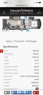

Here’s a question: When y’all are looking at 5’ers (never owned one) do you determine anticipated pin weight by what they state, or do you do the math and take ~20% of the GVWR that is listed? The image below is a good example as to why I ask. That listed hitch weight is ~18.5% of the UVW. I always believed 5’ers to be roughly 20% of total weight on the pin, so if you add another 1-2k pounds loaded, that listed pin weight is only ~15%.
I’m getting a 250 (maybe should have gone 350 lol) and so those ~500 pounds could be the difference in something like this working or not...
I have always went with mfg's stated pin weight and added from there. Each item you put in the bedroom or the underfloor storage is going to be more directly on that pin weight rather than a percentage. Weight added say to the kitchen/living area or water tanks will be a percentage. In the end, I always go to the weight station. It'll tell you exactly where you are or where you need to adjust. I went enough times that I inherently knew where I was and stopped going over time. I always had room to spare even when I loaded as much as possible. (Full water tanks, full fuel tank, all our stuff in the trailer, two full ice chests in the bed, we just ate a big dinner and etc.

So specifically to the question of your formula, it's not an exact science. If you put 500 lbs in your closet, you're going to putting nearly 500 lbs more on that pin. If you put the 500 lbs in the living room in the back, it's not putting much at all on the pin if any at all. (remember that the axles are your fulcrum). Very evenly distributed 1.5k and then your formula has some merit, but is still a variable.

Thanks for the info, very helpful. So let me ask you, what is your philosophy on how you determine whether or not a 5’er will work with your truck? Buying one and then going to the scales to determine I’ll be exceeding payload no matter how I load it doesn’t seem efficient...Is there a general buffer you add to the pin weight that gives you some guardrails when shopping around?
My 5er was advertised as 2180lbs pin weight, but on delivery it was actually 2400lbs!. When you are totally loaded down in truck and trailer, it's a good idea to take a trip to the cat scales. Weigh you truck with full gas, passengers, and what ever else you put in the bed of the truck. After you get your loaded truck weight, then hitch up and weigh the loaded truck and loaded trailer together.

I hear you Wildwest, but my point is if I take the advertised pin weight as gospel and make the purchase, load it down, and weigh it and I’m quite a bit over, its too late. Cant tell my son, “sorry buddy, daddy effed up and bought too big a 5’er so you cant come camping with us” lol. Not trying to be a dink, honest. guess I’m just wondering what cushion I should factor in when looking into 5’ers and their pin weight so I can avoid the above example.

I allowed 1200 lbs over the pin weight. I saw the post above where his was way off. I can't speak to that, but mine was actually 100lbs less than stated.

Most trips I’m traveling with myself, wife, son, 65 pound pooch, step daughter, and one of her friends. On a given day that is ~700 pounds in passengers. Assuming a payload of ~2,600 lbs on my Tremor (guessing based on other posts) I’m cutting it close on a 5’er with a listed pin weight of ~1,600 lbs if you consider the added cargo outside of passengers. Loaded near the front I’m definetely over. Spread out, I’m still cutting it veryyy close. And that is one of the smaller grand design 5’ers. I know, I know, I’m babbling...but I guess I’m just saying it seems like most 5’ers are out of the picture for me unless I’m totally missing something...

You got it right. If you care about respecting your legal GVWR, the F250 is a very niche truck where you have a ton of power, heavy duty parts across the board, a big OOMPH over the F150 line, but you also quickly hit its legal limits.

Yup. Fortunately there are still some great TT’s that would be a big upgrade for me but wont put me too close to GVWR given theyre closer to 10% on the hitch vs. the 20% of a 5’er.
