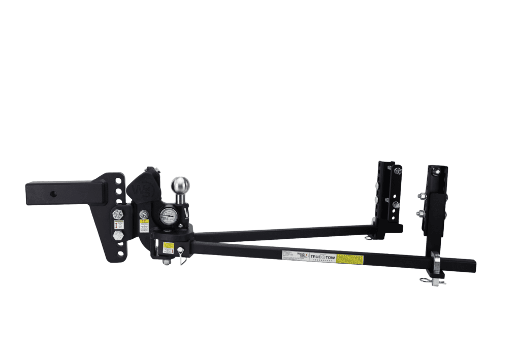

This is why I use the Weigh Safe Weight Distribution hitch - it moves the ball back about 1' allowing you to open the tailgate. One of the many nice features to their system.

I have 6" drop - mine faces in the "up" position - I got 8" first and realized the shaft was 2" longer - they have 8" of actual adjustability - but the shaft is 10" long. So I went back to 6" drop shaft and used that instead, as I did not want it to stick up or down any further than 8". With 6" shaft tailgate still opens with it in up position with plenty of clearnace - with 8" it will be very close to touching, if not hitting - when in Up position.
My ATC toybox has 23" ball height when level - so with OEM set up I was in the first (lowest) position with the shaft facing up.
Weigh safe was happy to swap out my original - but I had to pay shipping back of my 8".
If you change your mind and go back to 6" - call them today - likely not shipped yet and they will switch it out.

Hey guys, just saw your posts and comments about the lack of tailgate space when hitched. You may have already read about this brand but since you are both using WD hitches, you should read up on and watch the videos on Weigh-Safe WD hitch system. It has many cool benefits for standard pull trailers and it allows your tailgate room to drop while fully hitched.
