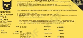

Here are my numbers with CAT scale weights. The first Cat scale is with the Tremor loaded without RV. Consist of 5 adults, full tank of gas, 5th wheel Demco Recon hitch installed, about 80lbs of miscellaneous tools, Viair 450P portable air compressor, Safe Jack recovery kit, extra 10 gallons of gas, extra 20lb propane tank....total weight=8520lbs.

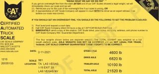

The second Cat scale is with everything above plus the hitched 5er with camping gear also with portable 3650 Watt Firman generator loaded in front RV compartment. The Tremor sagged about 3 inches so I filled the airbags to 40lbs for a total sag of 1 1/2 inches.
The spreadsheet shows the calculations with the truck and truck/RV weight. With this load we were dry camping and I tend to pack a little more gear when camping w/o hookups.
As you can see, with a GVWR of 11300lbs, I am at 11420lbs (120lbs over payload capacity) even though I am below the max GAWR ratings on both axles and the truck GCWR. My pin weight is heavier than I expected. I will load the generator on the rear RV hitch to compensate next time.
