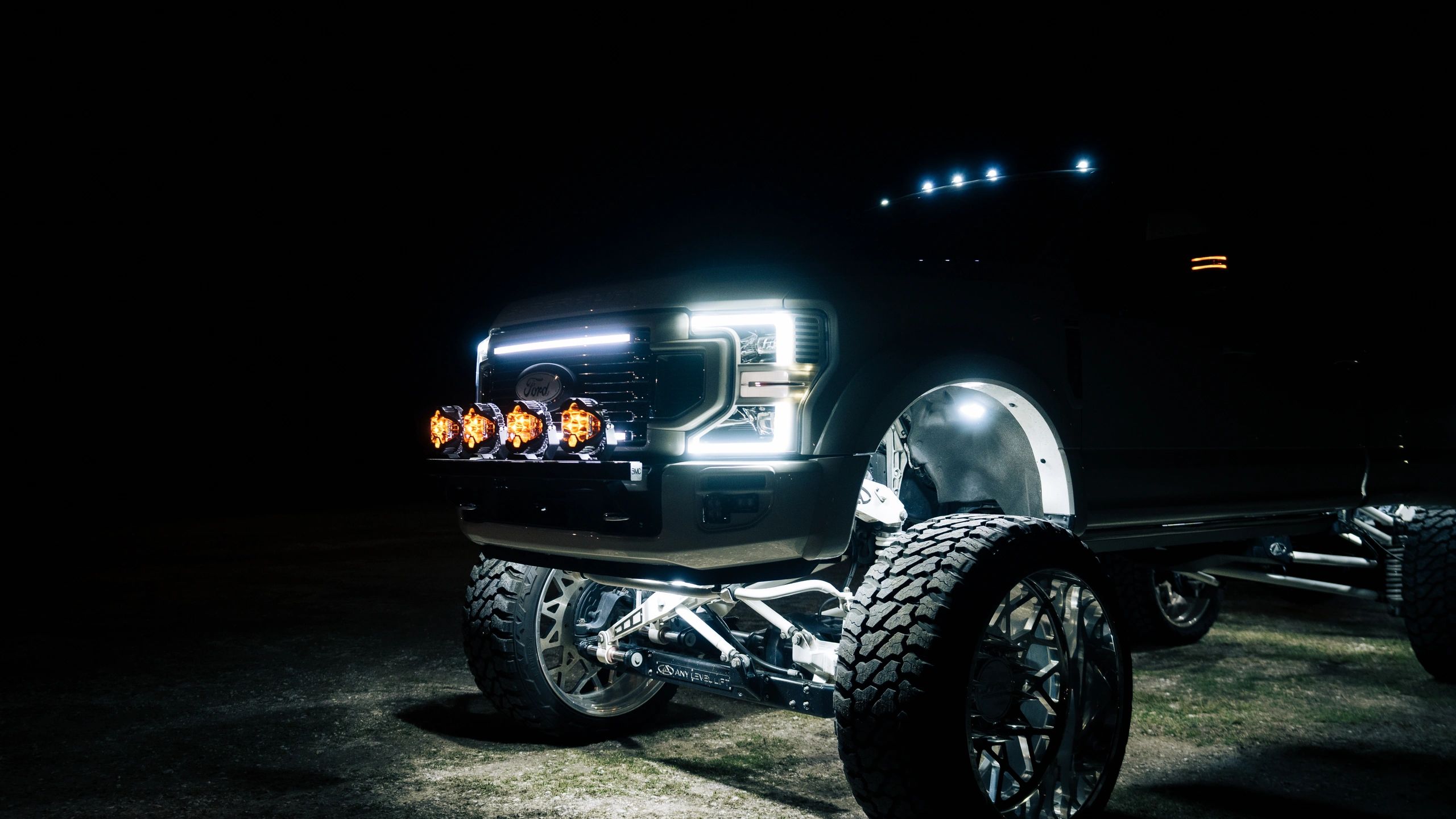

I just ordered the 7-link front light bar, two LP4’s, and two S2’s for the TRAMPER…. My suggestion if you didn’t would be to order the side panel blockers for those LP4’s…
If you’re going to run them on your A-pillars….
