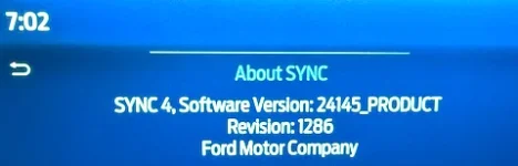

I just completed the APIM update with FDRS.
The new Sync version (for '22 MY) is now: 24145_PRODUCT with a revision of 1286.
I only had the APIM update available, as I did the driver and passenger door modules previously with FDRS in August of last year. The TCU was done via the OTA December 3rd update for me.
The Ford Sync splash screen has been updated; I have not noticed anything else yet. If I find anything else I'll update.
