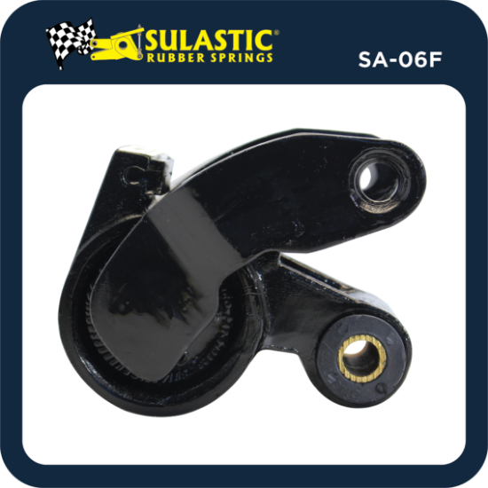

I was also thinking of adding Sulastic Shackles. I'm not sure if this changes the ride height. Thoughts?

I do not think the shackles change heights, you can get some that do raise / lower but I don't recall that being in sulastics catalogue. But yes some companies do make shackles that can change ride height I just don't think that's the business market sulastics caters too.
