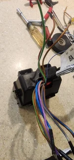

so pulled my auxiliary (up-fitter) swithches fuse box to get it setup to connect the lights last night.
here's what i found
so i decided to replace the whole thing, since the wear was starting to rub wiring
of course the new one has been augmented & updated 4 times now
the only real difference seemed to be the power cable.
so i cannibalized the old one. replaced it on the new fuse box
win one
been working all day on extending the power lines out of the up-fitter fuse box.
one awesome thing about replacing the old one was now having all the wires the right colors to extend the wires on the new one with.
win 2
pics of what i did all day. except the 3 trips to home depot & ace hardware
finally fell together pretty well
should get the lights wrapped up in a few more days

whats the trick to make the up-fitter switches live? is it all of them? just 5 & 6? is it available on a 2020?

Just 5 and 6. Move the 5 amp fuse forward and voila!

neither the old one or the new one will slide for me.
Scroll to 3:50 in the following video. Just slide that baby forward. You'll need a little force:

pulled the fuse. had to get a small flathead screwdriver in the far left side of the black sliding piece. it didn't want to slide. a little click and it slid. be gentle!!!!
but then the fuse didn't want to go back in. always something.
make sure the black slide is all the way to the right. the same direction as the pointed side of the piece that slides.
i got it all the way over, the fuse was tight but it finally slipped in & bottomed out.
all good
it is only 5 & 6 always hot
1 thru 4 still need the accessories on
fyi for anyone needing/wanting to know
