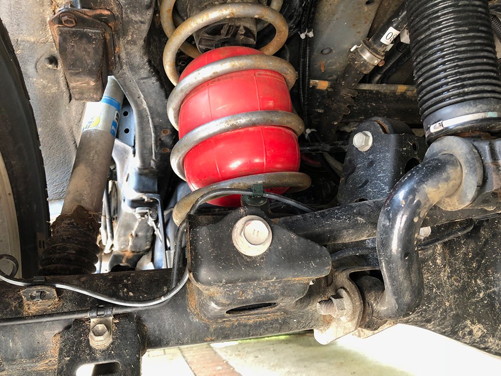

Air bags

Back to the airbags, my opinion is don’t waste your time or money. All they should do is level it out left to right. Most guys overinflate them and it removes weight from the springs which creates more control issues. The sooner you engage your leaf springs the better. Sway bar would be a better investment, second would be stableloads. If you really want bags, I will sell you mine.

Good point, if you do tow heavy, especially with a shorter wheel base, a rear sway bar will help assist. No rear sway bar on the Tremor package, but it can be added to help with heavier loads. A longer wheel base truck with sway bars is ideal, but work with what you have.

“Airbags are great, but they are not a replacement for a weight-distribution hitch (WDH) like the e2. When installed properly, a weight distribution hitch has the following benefits:
1. It shifts weight to the front axle;
2. It reduces sag caused by the trailer’s tongue weight;
3. It provides more stability when encountering cross winds.
Like an airbag, a WDH will raise back of the tow vehicle, reducing some of the sag caused by the trailer’s tongue weight. But the way a WDH raises the rear of the truck is key – it uses torsion to shift a percentage of the tongue weight to the front axle of the tow vehicle.
This is the key difference between a WDH and airbags. Without shifting some of the tongue weight to the front axle, you‘re likely to have problems in a fast stop or emergency maneuver. When you brake hard, the weight of the trailer shifts forward and pushes down on the hitch ball harder than normal, which causes the truck to lose front wheel traction. When that happens, you can lose steering and braking capacity.
A WDH resists the trailer’s nose-dive, and keeps the trailer’s tongue weight transferred forward. By using airbags instead of a WDH, in the same panic stop as above, the trailer weight will shift forward, pushing down on the hitch ball. The hitch will then push down on the rear of the truck. Since the airbags are resisting that downward force (at the axle), they become a pivot point, and the front end can get light very quickly. This can all be avoided by using the e2, which will help keep your front wheels on the ground, where they belong. And when you are passing semi-trailers or encountering crosswind, an airbag suspension system provides zero sway control.
With the e2 hitch, you have two points of sway control, in addition to weight-distribution, providing safety and security for both your trailer and the important cargo sitting on the front seat next to you.”

Weigh safe will make getting your truck level and safe much easier when you get those airbags put in.

So I hooked up my toy hauler today after having the ready lift 2.5 installed and I’m wondering if I should get airbags because I think she squats a little bit look at the picture and tell me if you honestly think I should do the airbags ? Trailer loaded is 17000lbs
Have you tried adjusting the WDH? I’m assuming you had the trailer before you had the Tremor and if the Tremor is taller than your previous truck you need to adjust that WDH. I had to do that with mine.

I did adjust it thanks

I had the same thoughts when I bought my truck and trailer. I have a similar sag. but after researching much like yourself, I decided against airbags. It’s simple, bags don’t add payload. As long as you’re within the weight limits and use a nice torsion bar setup, the sag doesn’t matter. Your Tremor will be more than capable. again, gotta stay within the weight limits. This is what I’m running currently until my 350 arrives. R6 recurve torsion hitch on a Lariat f250 6.7 with a “p#~~y” of a payload @ 2180lbs.
The camper is a 38’ toy hauler with a GVWR 13,800lbs. I am within all my weight limits and the ride is great!
