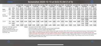

I even went back and checked the chart in the manual to make sure I’m not crazy. But yes, the dude is complaining about an inch squat on a trailer 2000lbs over the legal limit...

I'm curious about the legality. I guess Ford sets the GCWR of the SRW F350 at 30k pounds. Then says max conventional towing for Tremor is 15k.
What's the actual legal limit - stay under 30k total GCWR? Or the 15k conventional towing is another limit it has?
The 30k requires the high capacity trailer tow package and he has an F250
And the notes at the bottom say not to exceed maximum trailer weight listed
And. No matter if it’s an F250,F350, gas or diesel, they cap all The tremors conventional towing at 15k. No idea why
The tires limit the 350 Diesel to 15k or it’d be 20k
Yeah, that's what I'm trying to figure: what's the legal limits and what are the "your warranty is now void" limits.
