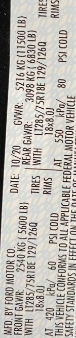

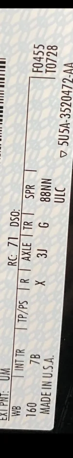

Got some interesting numbers to share. I took my truck to a CAT scale to weigh today.
Stock truck. No cargo other than myself. I weigh about 165 lb.
Fuel tank was between 3/4 and 7/8 full.
Steer axle: 4880 lb
Drive axle: 3220 lb
What I find interesting is that the GVWR of the truck (11,500) minus the actual gross weight (8,100) equals 3,400 lb of available payload. This is pretty close to the “sticker” payload of 3,294 lb.
Additionally, on the Rear GAWR sticker rating of 6,830 lb minus my actual rear drive axle weight of 3,220 lb gives me 3,610 lb of headroom on my rear axle without overloading it. This means that I would be over the GVWR of the truck before I was ever able to be over the Rear gross axle weight rating.

I have the same truck. Can you tell me what the maximum trailer weight would be? We will be towing a fifth wheel with ours.
If you have the 'exact same' truck then subtract you, your pax, your fuel load, and everything in the bed from 3294. The remainder is how much tongue weight you can legally handle.
You do know your pin weight?
Note that I said 'legally'. It doesn't matter what the Cat scale and your New Math says if you plow into a soccer mom and her kids. Her lawyer will only want to know your door jamb sticker numbers and what all you have in the truck and the 5er pin wt.
The hitch weight of the RV is 2040. Truck Sticker payload is 3265.

If you have a hitch tongue weight rated at 1800# vs a hitch rated at 2100#, it also makes a huge difference in liability. You can tow under your payload, but over your hitch rating and still get your pants sued off you. 2040# is huge and perhaps some redistribution of your load can reduce that. But yes, you also need to to keep in mind the total payload as well.
