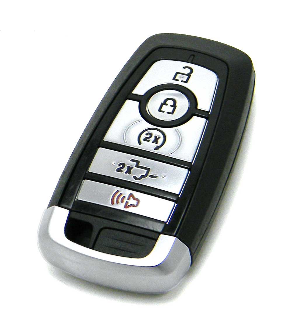

Got my OEM fob from Northcoast Keyless. It's identical to the fobs that came from the factory, with battery installed - $64.94 including shipping and no sales tax.
View attachment 28199View attachment 28200

I received my key from NorthCoast yesterday and programmed it per @RedZilla directions on my 2021.
It seems odd to put the key facing forward as it does not fit into the cutout but I did and it programmed my new 3rd key successfully the first time!
This is the way I positioned all 3 keys during programming.
Thanks for the great directions @RedZilla!
Refer back to this picture, this was the only way I finally got mine to program.
