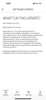

Got an alert today from Ford Pass app

So when among these updates does the spyware get shoved into us?
Oh, wait?!?!?
:cool::cool::cool:
You accepted that into your life the first time you logged onto the internet. ...and again the day you bought a cellphone.
