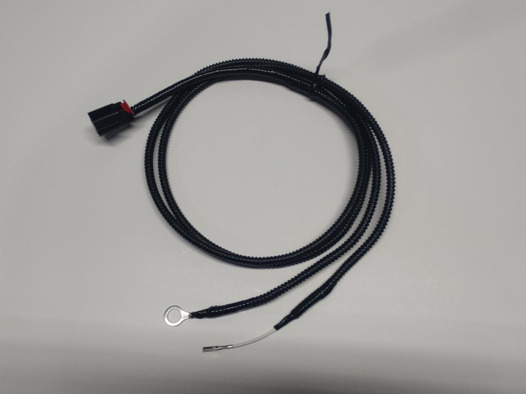

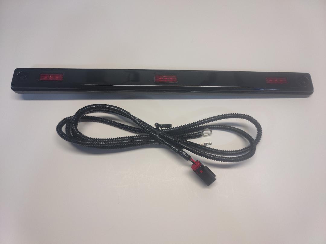

They sell a kit too w the light for $95. I just installed it on mine today. It looks identical to the more expensive harnesses and the light is prob the $35 ebay/amazon version. Looks like oem, works fine, the instructions are good, the zipties and small parts came in a ziplock sandwich bag. Lol. I'm happy w it.
Here's a link. It's hard to find on their site and they only have it listed for '17-20. It's correct for my '22 and fit fine.
