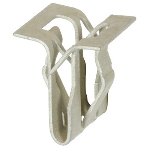

Clips on 24 grill
Those of you that have taken off the grill do you just muscle (pry) the edges of the headlight ring or is there some trick to getting the clip barbs to release?

You're correct @mrmag00 there are clips that clip into the grill surround which clip onto the tabs on the headlights. Good news is I've never lost one because if it wasn't still on the headlight, it was in the grill! :ROFLMAO:

I’m puzzled now. I know for a fact that my 23 came without any such clips from factory. I took the grill off 4 times by now. The photo is from the 1st time. It’s good to know that i can add these clips for a better hold, but i’m not really sure if they are truly needed.

Can't really tell from the picture, but it looks like yours stayed on the headlights as designed...located here:
Hard to tell from the picture but looks like the clips are still on around the headlights, maybe there’re supposed to stay on the lights and not come off with the grille. Looks like the clip has 2 fingers to hold it in so it pop free from the grille not the light.
⬆️⬆️⬆️⬆️ Exactly
and if they do come off with the grille, I just take them out, bend the little teeth down and put them back on the headlight for when I put the grille back on

🫢🫢🫢 i feel like an idiot, lol, didn’t notice these clips until now.
Just how tight do the clips attach the grille around the headlights? I noticed while washing mine some time ago that the surrounds seem fairly loose, like I can press them towards the headlights quite a bit, or even pull them away. I haven't thought twice about it until seeing this thread. Now I am wondering if I'm missing a few clips.

Even with the clips, the area around the headlights is still not very snug. There is a lot of play.

Here’s what ends up happening if you take the grill off 4-5 times, or if you’re not particularly careful when doing it, could happen the first time. I noticed just now, on my 4th time, that one of my clips was broken. I super glued it back, remains to been seen if it will hold.
