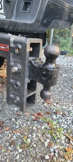

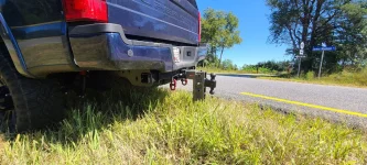

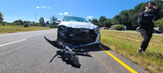

Pictures of the kill
Several people are posting their 3 inch hitches. Makes sure you get the right size for what your truck has because I'm pretty sure the f250 comes with a 2.5 inch receiver so if you buy a 3 inch you will have to buy a sleeve which is not ideal.
If you have high capacity on a 6.7 f250 it has 3 in but 7.3 are 2.5 but just make sure what hitch you have before buying anything
so i remove it but on the top spot the pintle hook latch will slide all the way in and not be in the way but i just remove it if it going to be a long haul but i just try to keep the hitch together in one piece so i don't loose anything but that the big reason i went gen y i wanted pintle hook and ball and this hitch does both ... i don't own a trailer so i rent alot of different trailers and having both option is the best for me and this hitch has killed a car ... so it has a confirmed kill

i got mine $250 off on a amazon warehouse deal ... it was $550 for this one i believe ... couldn't pass it up

Did it total her car? Thats is a killer!
yep cracked the engine block and broke the drive side motor mount .... on top of killing the front of the car .... quoted 30k in repairs car as a 2018 only worth 18k
