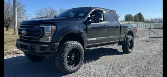

Carbonized Gray : If you zoom in on the second pic, those specks are the flake I had them add to the top coat. Not too crazy, but gives it a little kick in the sun. After getting these done at that shop, I had an idea to get my old 305HDs done, just need to pick a color. I learned a lot from the shop owner about how the coatings work, the layering, get applied in order.

Just installed a wicked 2.5” level and Hostile Vulcan 20x10 -19 w/ Toyo RT trail 37/12.50. Still have a bit more trimming do but really happy with the outcome thus far.
