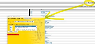

I have a problem with the Ford Software trying to look up components in the electrical area. When I select component and try to find any components its not found. Unfortunately this is for my 2017 F250 truck and I purchased this software many years ago.. I just wonder if the same issue exists anyone else's.
