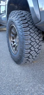

Just picked up a set of these Yokohama Geolander A/T XD tires in the stock Tremor size 285/75/18 they are 3PMSF rated and stud able with nice factory sipping. I live in interior Alaska and plan on studding them for use exclusively in the winter. first impressions are they feel much softer than the Duratracs and they have a slightly deeper tread at 19/32" vs. the goodyears 18/32". they are fairly new to the market but I found them on Amazon for $365/tire so for a 10 ply load range E tire they are also more affordable and more available than the goodyears.
I also just ordered a set of these tires in stock size. SimpleTire is advertising these at $304/ea. Discount Tire matched their price. Discount guy liked these over the Falken Wildpeak AT’s. Probably won’t stud them but it’s an option. Curious how these differ from the Yokohama Geolander AT GO15?
