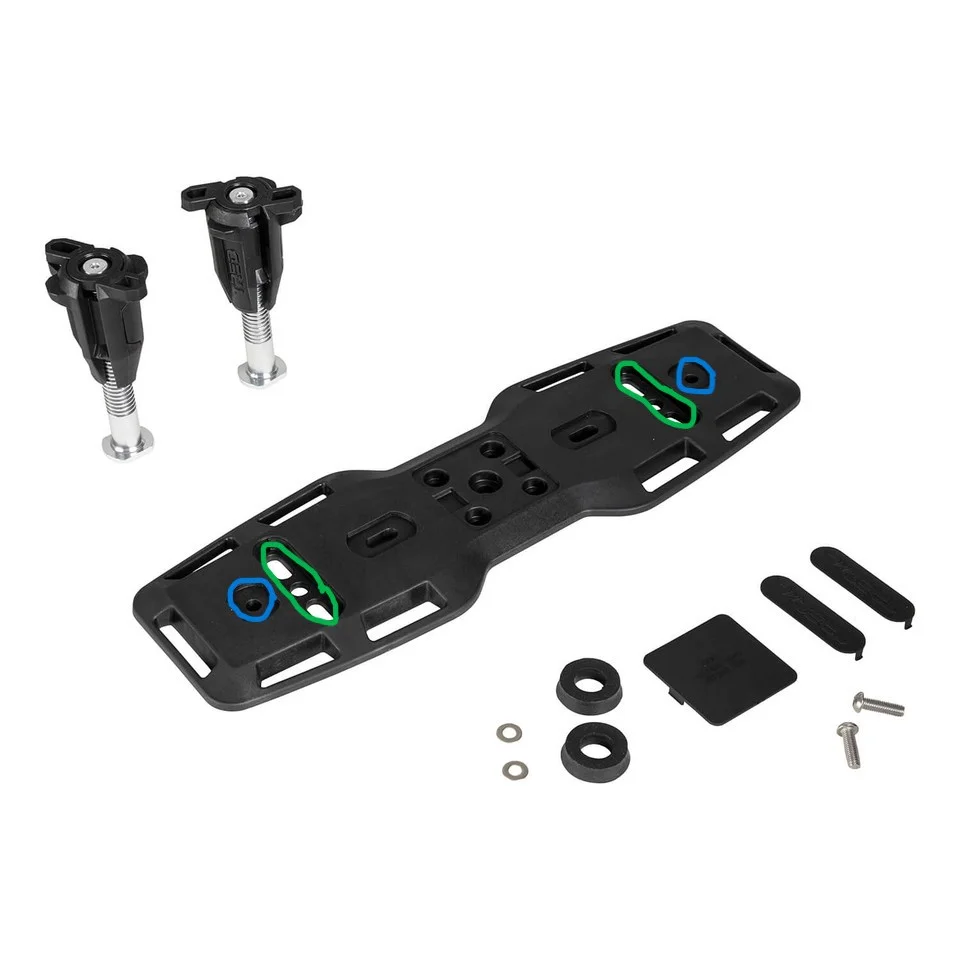

This looks great! I take it the mounting pin spacing is the same between the Maxtrax and Tred boards? (Yours look to be Maxtrax like mine).
And the spacing of the mounting holes on the bracket allowed you to mount to both top and bottom extrusions on the camper?
Basically, just confirming that you were able to run 2 mounts in a vertical orientation, using the blue holes for the board mounting pins, and one of the holes in the green circles to attach the plate to a threaded hole in the camper extrusion?

So I took some pics for you, and yes, maxtrax fit perfect. They did shave off a bit(circled) to make it fit between the frame rails. Third pic shows how it's mounted.

Thanks so much, that looks great and probably the way I will go!
For what its worth and anybody else following along, I did email OEV for their advice, and here is the response from Erik:
"We have had several people do this, we tell all of them drilling and using a rivet to attach mounting brackets to the extrusion is ideal.
Use a locking rivet, don’t drill deeper then 1” (walls are 1 5/8” thick), put Sika 221 in the hole before installing the rivet to ensure a watertight seal.
I believe most people just make a pair of aluminum strips that connect from top extrusion to bottom extrusion and put the Max Traxx mounting pins on that."
