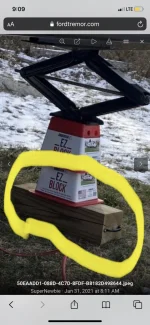

Do another block on the hitch
I building one out of 2x12 now. Cut a 10‘ down to 12x12 pieces. Stack and screw them together and going to router a 1/4” deep circle in the top for the tongue jack’s foot to sit in.
Just get length of 6x6 and cut it into 18”-24” blocks. Screw a couple handles into the ends to easily carry. Keep it simple

I think I got it where it needs to be in the driveway. Perfectly level. Still need some more leveling blocks for out of the drive but I’ll pick them up later.

it didn’t really feel unstable the other way, but I feel better now that I created the 2x12 block set under the tongue jack, so I guess the answer is yes. I also appreciate all the input from the members on here. Thanks a ton guys.
