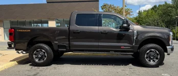

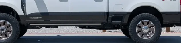

Really wanted a two tone Tremor but didn't want a King Ranch. A few dealers have been offering "aftermarket" two tone packages; same style as the king ranch with the bottom 1/3 painted in the accent color as shown, but painted after delivery. I talked to my body shop guy and he said it won't hold up long term, as the factory two tone is done BEFORE the clear. So if a shop runs that accent across the bottom there would be a line that is subject to peel etc. Only looking to do the bottom panels, not the bumper, no fender flares etc.
Anyone with paint experience have any thoughts? Would rather not have it wrapped. My truck is the Darkened Bronze Metallic, would like to do the bottom part in Stone Grey.

I don't know if I agree with the paint guy about it not holding up but I would agree that there would be a line on the clear.
With that said, I would personally would have them sand down the clear on the door and body where the two tone is going. Not just the immediate area but the whole panel and door. Paint the two tone and reclear the whole thing. In essence, you're repainting the whole truck which I imagine is't 4X the cost and ultimately isn't worth it.

Hey, your image came out better than mine, Gemini tries to add fender flares each time. The color is just a different shade of tan, not grey. Stone Grey Metallic. The white truck was just an example of where the paint lines go.

Right, thats the debate. Would it hold up with a layer of paint then a layer of clear. This would cause a pretty big "ridge". it does tuck neatly away in that body line however.
Any yes I agree if you were to re clear all the affected panels that would be completely cost / work ineffective.
