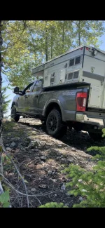

Just put the Four Wheel Camper on my truck.
I can’t decide if Four Wheel Campers we’re made for Tremors or if Tremors were made for Four Wheel Campers? I think the Tremor is the perfect unmodified platform for an FWC. I ordered a F350 7.3 Tremor for my Hawk on Monday. Other than wiring for the camper I don’t think I’ll do a single modification.
My camper should be ready for pick up in six weeks or so. It looks great in your photo and its a bummer we will be missing most of the summer but looking forward to winter camping with the thermal pack and furnace.We did ask for the shower and toilet inside (must haves for the wife!) so I hope the truck still handles well with the added weight.
Are you still using it without modifications as it shows in your picture above? I've been thinking about how to add some extra storage outside but I won't really get anything until the camper arrives and I try it out for a while.

Nice. The added weight doesn't seem to make it squat at all. Actually levels it out quite nicely. Was that fully loaded with water or without?
No water in the photo, that was just after they installed. Dry weight is just under 1600 lbs. Door sticker says 3050 lbs passenger + cargo payload so I think we should be fine when loaded.
It did level out nice and the ride is softer with the weight but I’m still getting used to it, you can feel the higher centered weight in the turns. I’ll try it out stock and see if I can get use to it.
