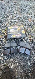

so upgraded the brakes to the power stop towing brakes in just the front ... and just the pads ... i been runnning them for 2 weeks now and the stopping it so much better and it works with no issues but when i removed the stock pads them started to far apart .... the metal came off the pads ... and i am stocked that happened... but it came apart ... but powerstop you can stop and alot quicker with just nicer pads and also no dust which is great
Also big difference in pad size
