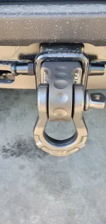

I got the B&W drop hitch and this Warn Epic D-ring with a a Factor 55 hitch receiver shackle mount for when I'm not towing. I've used these types of mounts a lot on my Jeep and quads, plus I think it looks cool. ?
