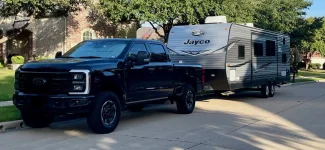

My question is why is your trailer swaying in the first place? Sway control (sway damping) is a band-aid for other set up problems. If you have a sway problem but don't need weight distribution, maybe you do not have enough tongue weight. What does your trailer weigh (on a scale, not what the salesman told you) and what does the Weighsafe say you tongue weight is?
I have a scale ticket for a weekend run (so not much onboard. No water) vs a scale ticket of my truck in normal “empty state” as a comparison.
The trailer was 7900lbs. The drive axle on the truck went from 4340 -> 6220 - but that’s also with gear in the truck. The weigh safe ball scale on that trip read just shy of 1200.
As for shifting weight to the front, in this case the front axle on the truck barely moved, even when I had the bars and the head adjusted to the right angle (or so I thought from the weighsafe adjustmwnt). It went from 4820 -> 4860.
This truck + trailer setup on a non-WDH has gotten me several places - but the occasional wind gust is felt. I don’t really mind it so much - but the trailer is more live and moving that with the weighsafe on. There’s also the wife component here. She doesn’t like it when we are on the road without it.
My whole thinking now is that 1200 tongue weight isn’t worth the WDH pains and I really just want a friction bar setup to control a bit of sway. I am also happy imagining not dealing with the limitations and the pain of getting the bars on/off.
Oh, for context, our trips with the trailer have been anywhere between local in-town and 4500 miles round trip.

First - get it on some scales so you accurately know what your axle and tongue weights are when setup for travel. Plenty of people have solved sway issues once they moved some of their stuff around. I have no doubt the WD hitch will make a difference.
FWIW our MY22 Tremor swayed a bit a few times while towing our 27' RV (similar weight as yours). Our MY23 (not a Tremor) doesn't seem to have that same sway. IIRC the Tremors don't have a rear sway bar. Perhaps it is a combination of the tires and suspension differences with the Tremors.
