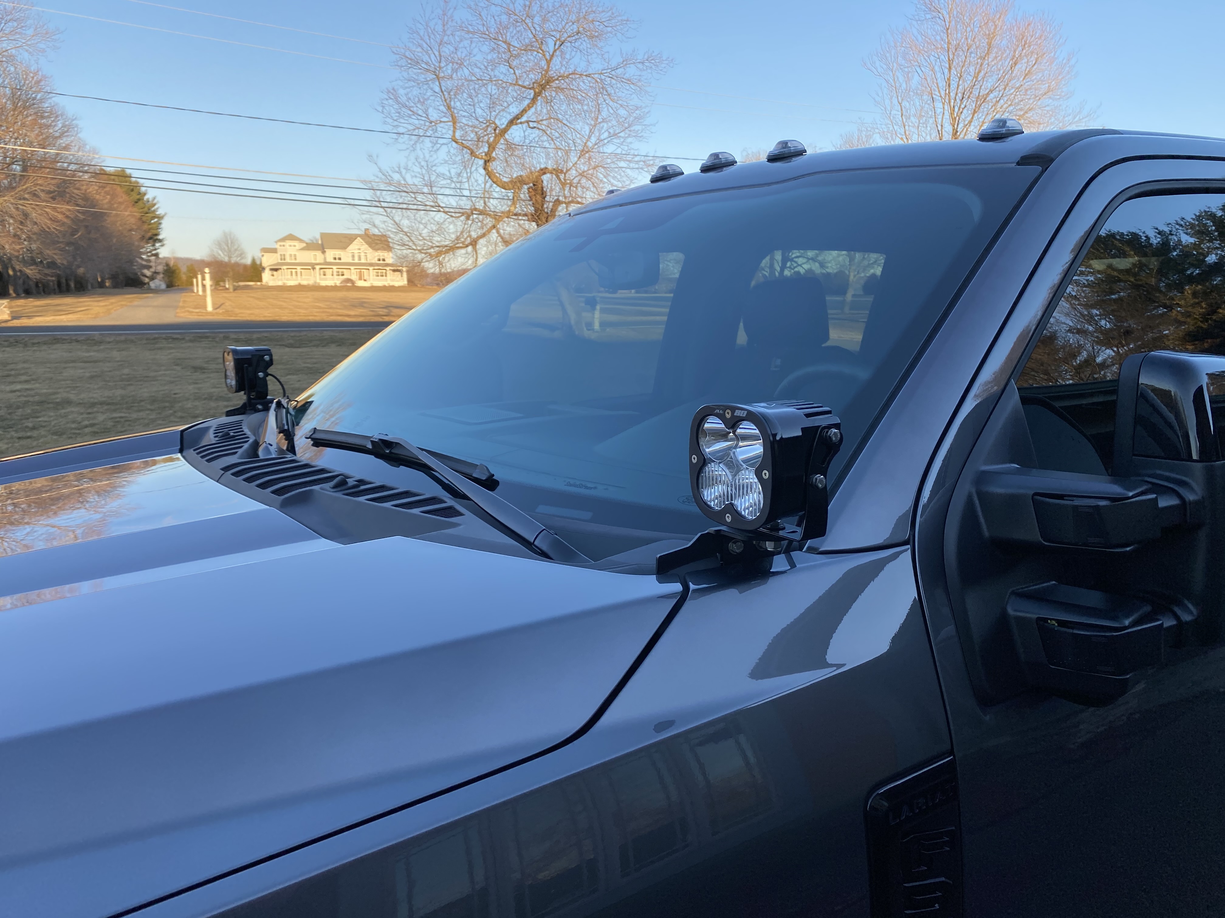

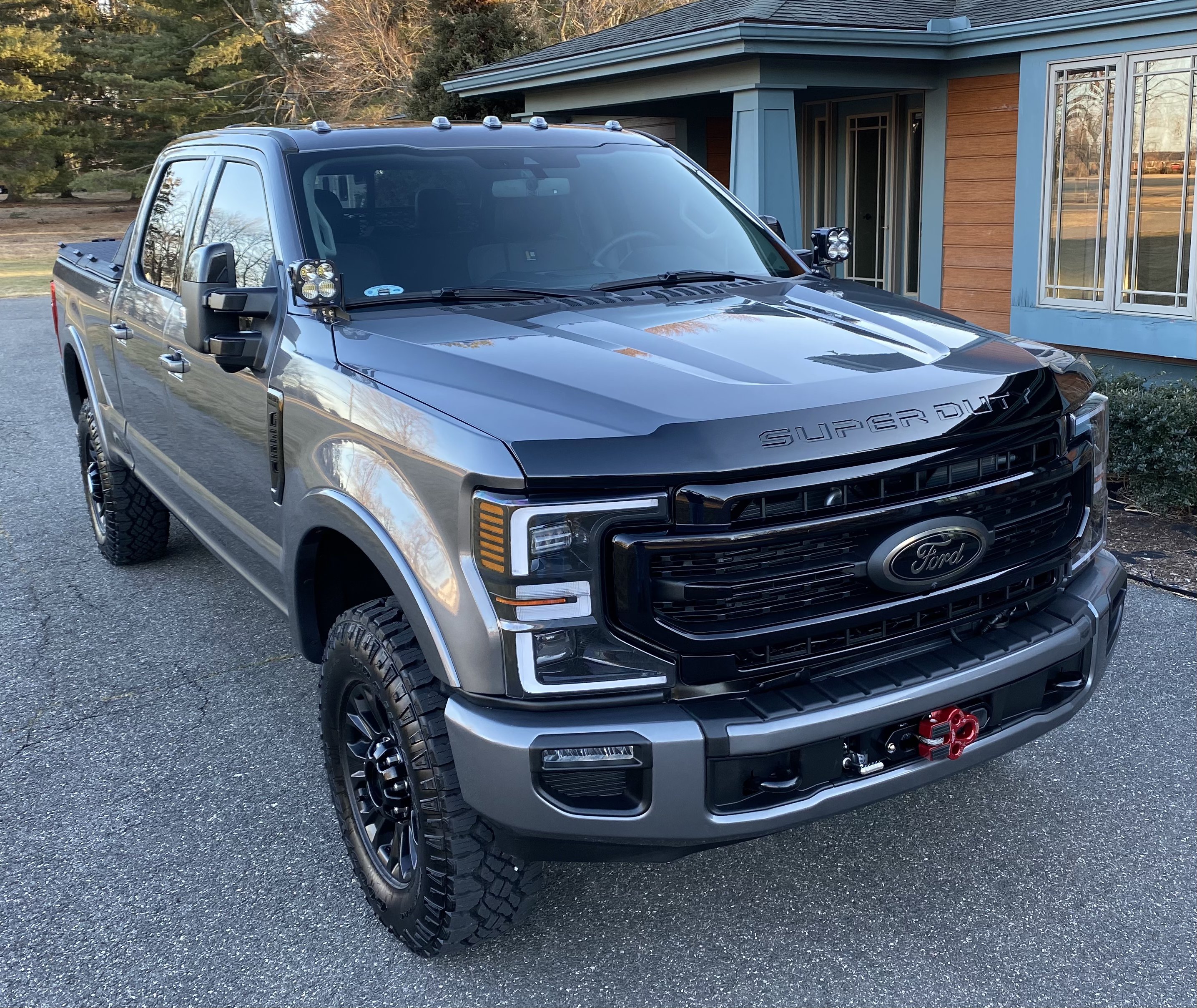

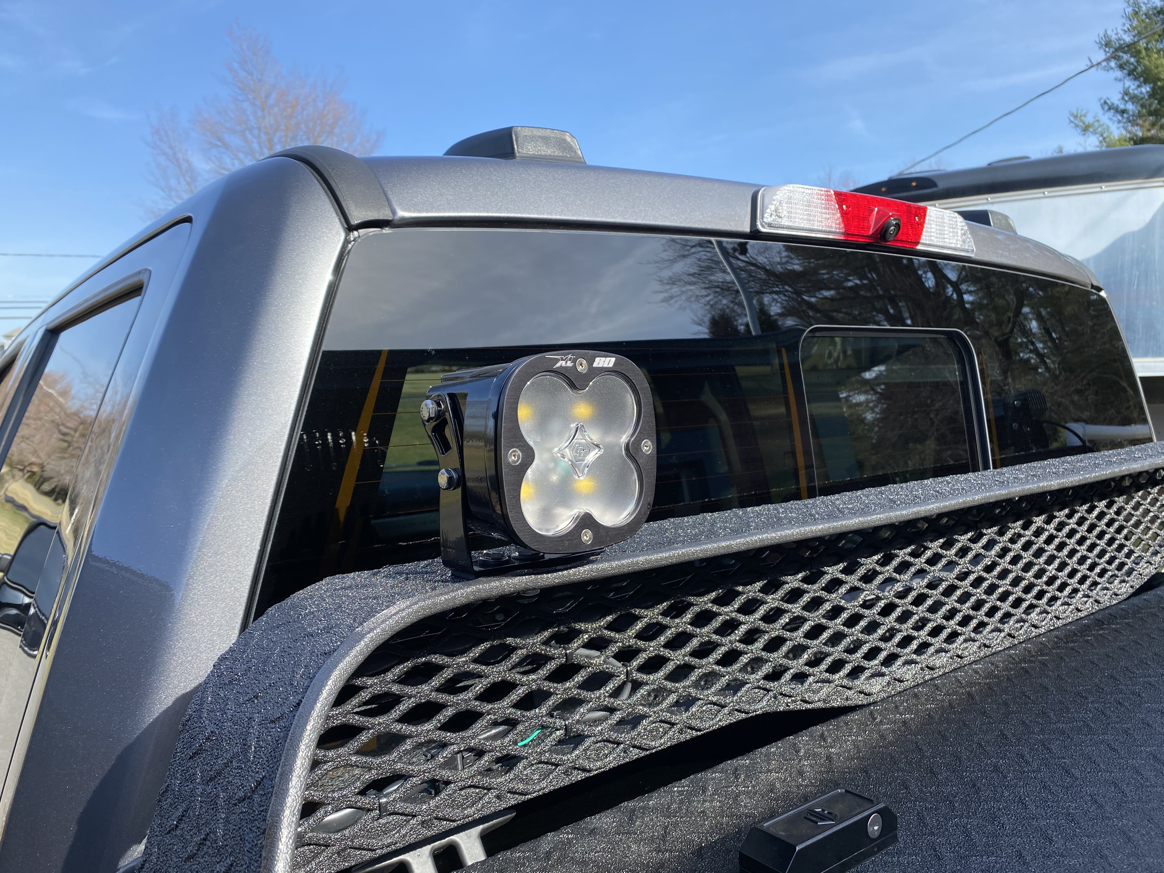

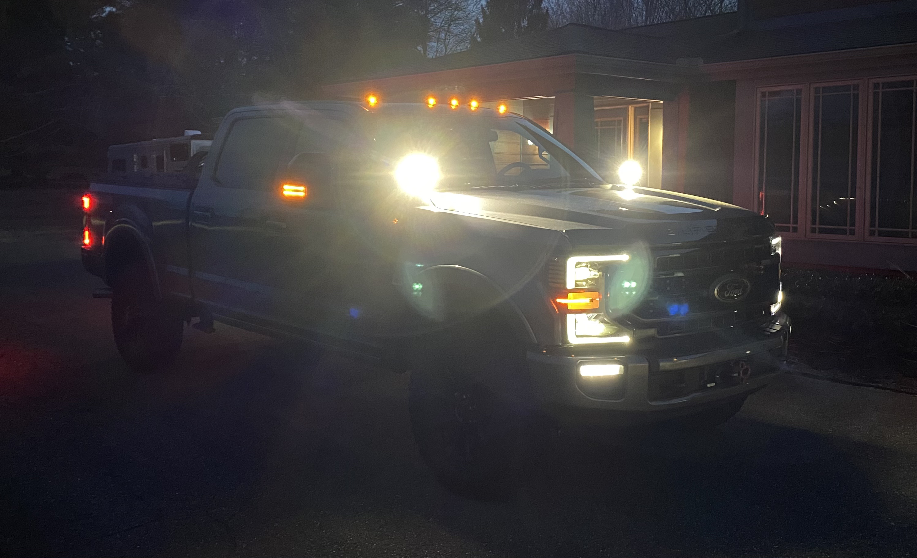

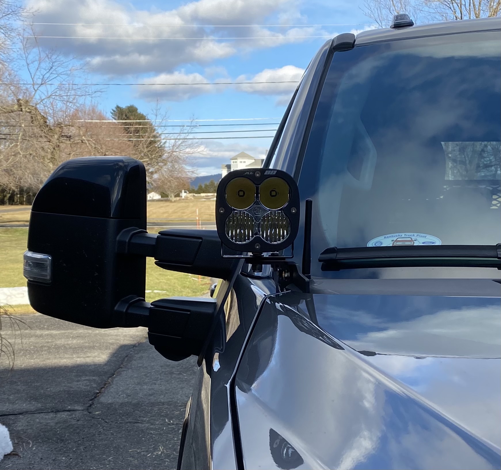

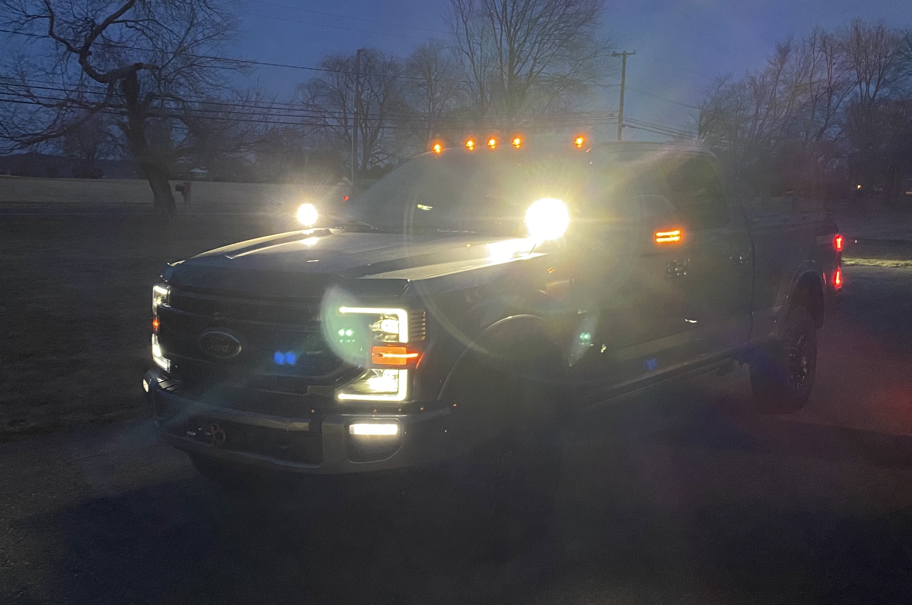

I was finally able to complete the install for my XL80s as well. At the pillars, on SDHQ Mounts, are the Driving/Combo configuration and on the Diamondback Low Profile Cab Guard, the Work/Scene configuration. I also powder coated the brackets and shock mounted each light.
I've been asked if I used a dimmer, but I don't recommend a dimmer with LEDs. Instead, I wired the green wire through a relay to provide a switched ground for Low Power Mode. All functionality is wired to the Upfitter Switches.
I believe I'll also add the Reverse Light Kit and have already accommodated the wiring into the harness I made for the Work/Scene Lights. The Reverse Lights will light up close perimeter shadowing created by the mounting location of the Work/Scene lights.
MB
